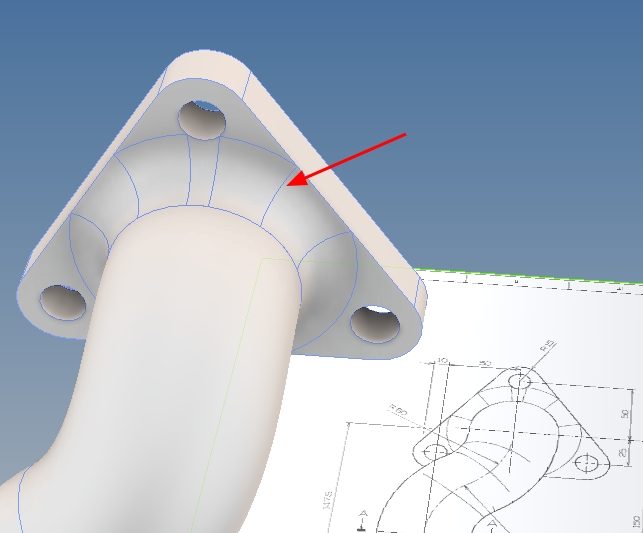

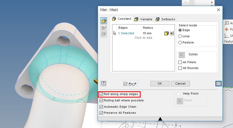

In the original drawing, a line should be added to the round (fillet) part.
If you check the detail option like the image, it will come out with the original drawing. :)
I hope this helps.
