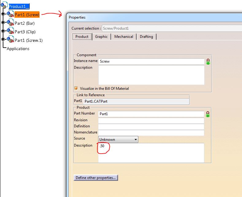

Hi everybody. I thank everyone for watching this topic. I consider when I created a part or a product is assembled. I want to calculate that cost? I what to do? Does the CATIA software support it? If your understanding. I want to you help. thank you.
If you know each component price, you can place that into the Parts, (Description) by right clicking > properties. If you have duplicate parts such as fasteners it should populate all of them.

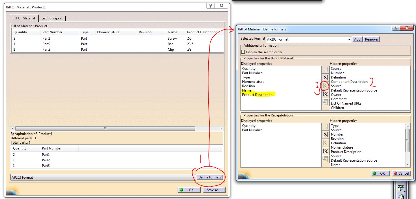

Then when you are done with this step, you can output a BOM by going into the Analyze > Bill of Material tab.
You will get a window as shown to the left, the top portion will show you what will be displayed in your BOM. If you don't see what you want, you can configure it by clicking on Define Formats.
It brings up the window to the right, and you are able to move the Hidden Properties by clicking on them and moving them to the Displayed Properties. (follow numbered steps below)

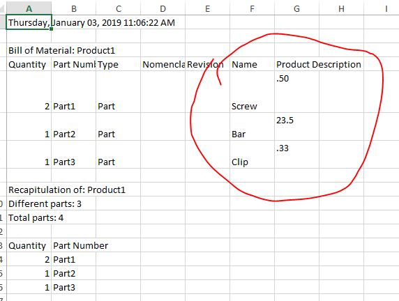

When you are done formatting, select Save As..., make sure in your Save Dialog window, you change the format from txt. for .xls.
When you open your Excel workbook, it should look like this.
Then you can sum up your cost from here! At least this is the only way I know how to easily do it while also giving you some other useful information.
