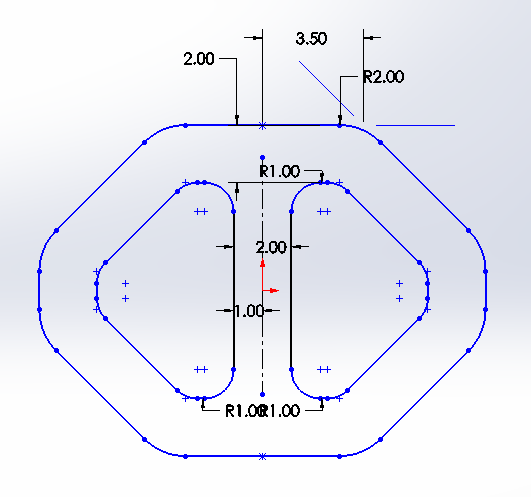

Hi There
Increase the wall thickness of the Rods to 2 or 3 mm and fillet the sharp inner and outer edges.
Print the two rods separately from the body and then glue them together
If you want to print the pieces together, place the bottom of the rods completely parallel to the heatbed.
Good luck
