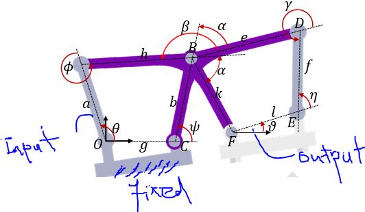

I was trying to make a mechanism which have 1 rev input to get 90 degree oscillation output at the end link.
This is the case I've made and its input is quite small range while its output angle is really wide ROM. I need the reverse.  Thanks in advance for the help
