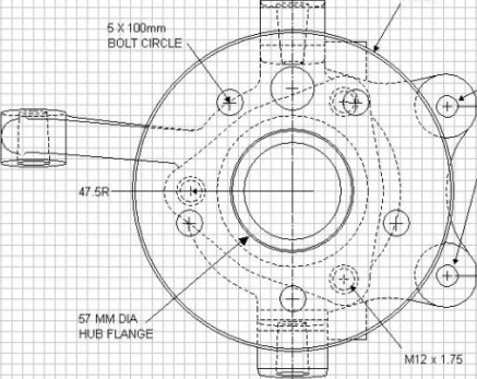

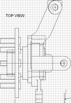

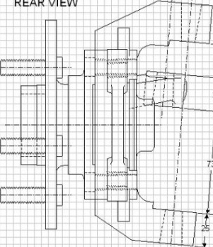

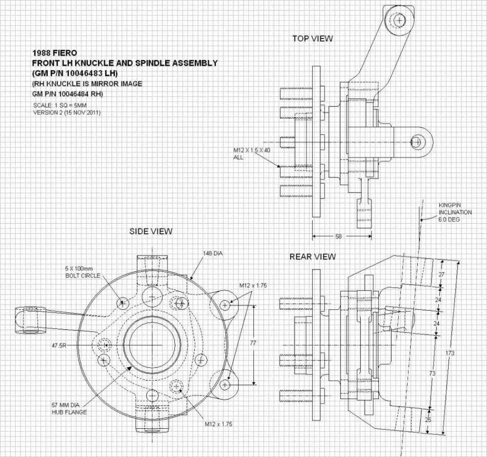

i am studying as an mechanical engineer. i have developed a huge interest in designing field. i drawn several components using tutorials.it was nice experience to in exploring it.but now i need to design steering knuckle for ATV.so please anyone help me on it . if you send me a tutorial it will be very useful for me to learn i will never forget you in my life.i will attach the image of the steering knuckle.the image is just for the shape of the steering knuckle.
Do you have any dimensions, side views, etc.
Designing it accurately from just a photo (a single view) is probably impossible...
Tried to design it, but many dimensions are still missing...
You got this drawing from google, so I searched for more accurate drawings but didn't find anything useful.
If you need it soon, why don't you download one from GrabCAD?
If this is a model that is to teach you how to use the program/draft, then in my opinion, the dimentions given are the important ones. The paper has a grid and a scale for that grid. It looks like you can approximate where edges and features are with respect to the dimentioned features.
I believe there is enough information in that scetch to make this part.

In solid works I would start with a revolve around the center of the berring so that will be the origin of the part and easy to reference all features from that point.
Then in the front view I would extrude some features to have a solid to work with to revolve cut the tapered holes that are on an angle . Then 8I would extrude cut the profiles in the right view to shape the lugs.
Just take one feature at a time and create a feature then trim it to the specific shape. The whole idea of an exercise like this is to get your mind to think differently. There are many ways to make this part, use the tools you nderstand and chip away at it.

This model is mostly arcs and circles. The hardest parts are keeping everything from falling apart because of all the tangent arcs (easy to mess up those relationships). The arm that sticks off at an odd angle. And of course, trying to figure out where all the lines are meant to be.
Looking forward to seeing what you come up with.
I'm pretty sure this part is actually two pieces pressed together. I doubt that explains the blocked holes, but it is a possibility.

On each reference plane, start a new sketch, then use the Insert - Sketch Tools - Sketch Picture tool. Once done, you'll be able to see those images, along with any model you create.
If you watch some Youtube videos on how to design a car, or other complex geometry, they will perform the same type of setup with the front, top, and side views of the vehicle.
