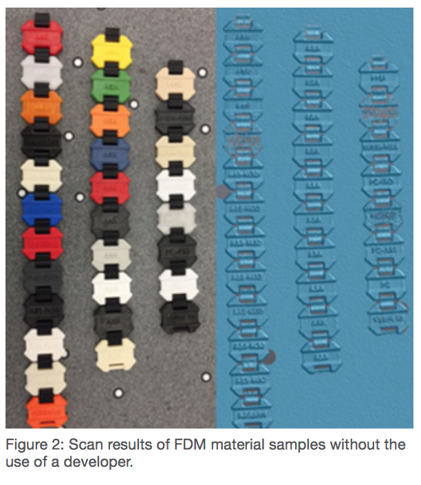

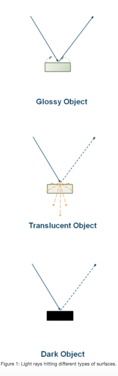

    2. 1 Scanning Glossy, Translucent or Dark Objects
    Scanning glossy, translucent or dark objects can be problematic because of the way light interacts with the part’s surfaces. For glossy objects, light reflects at an angle equal to the incident angle, resulting in only small amounts of light being collected by the scanner. For translucent objects, light doesn’t reflect off the surface but is instead scattered throughout the volume of the part. For dark objects, most light is absorbed by the object’s surface rather than reflected.
    Scanning an object that has one or more of these characteristics might result in undesirable scan data.
    To overcome these issues, spray the object with a water-soluble anti- reflective powder such as Magnaflux Spotcheck SKD-S2 Developer. This allows the scanner to pick up the object’s detail. The developer makes translucent parts opaque and glossy parts matte. It is also possible to cover the object with talcum powder if an anti-reflective developer is not available.
    After the scan is finished, remove the developer from the part with a damp cloth or penetrant cleaner, provided it’s not solvent-based.
    The use of developer is effective when trying to capture the shape of glossy, translucent or dark objects, but results in muted colors when trying to reproduce the original color

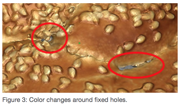

    After scanning a model and before sending it to print, make sure that it is watertight – meaning it has no holes or open shells. Scanning and processing a colored model is more complex. Creaform has developed software called VXelements that allows you to collect, analyze, and edit information from a 3D object. This software also offers an option to close small holes during the scan, but sometimes there are holes that cannot be closed. In these circumstances, use VXmodel or a third-party software such as Magics or Deskartes, which have the ability to close holes and prepare models for print.
    Be aware that fixing holes with other software might result in broken or missing textures, non-uniform textures and drastic color changes near the fixed hole. To correct this, import the texture file into design software such as Photoshop and edit the problematic areas.

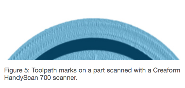

  8. Step 8: Setting the Correct Resolution for Inspection
    When scanning a part for inspection, use the highest resolution available for the scanner that is sufficient to inspect the part. At this resolution you will be able to capture all the details of the scanned object.

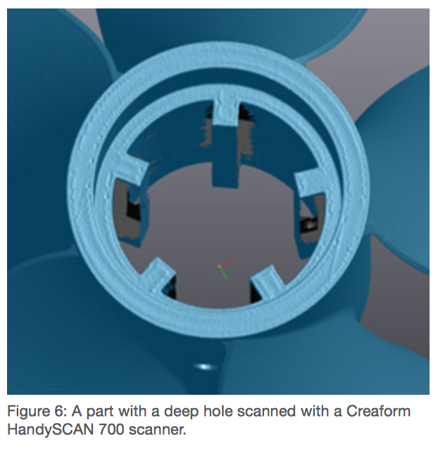

  9. Step 9: Depth Limitations
    One of the advantages of 3D printing is the ability to print complex geometries. When trying to scan deep holes and crevices, some scanning technologies will encounter problems collecting data in those areas. This is due to the design of the scanner and the distance between the scanner’s cameras (the two cameras have to be able to see the same area in order to collect data from the part’s surface). Each scanner comes with its own limitations, including size and depth of readable holes. Even though you are not able to collect all the information from the hole, the data collected from the scan can still be used for inspection of the part or can be filled for reverse- engineering purposes.

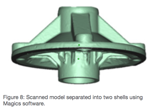

  11. Step 11: Separating the Scanned Model into Different Parts
    Sometimes after scanning an object there is a need to separate it into different shells to print them in different materials using PolyJet 3D Printers. This process can be done using different software packages such as VXmodel or Magics. After saving the shells as STLs, import them into Objet StudioTM or PolyJet StudioTM software as an assembly and assign your desired material to each shell.
