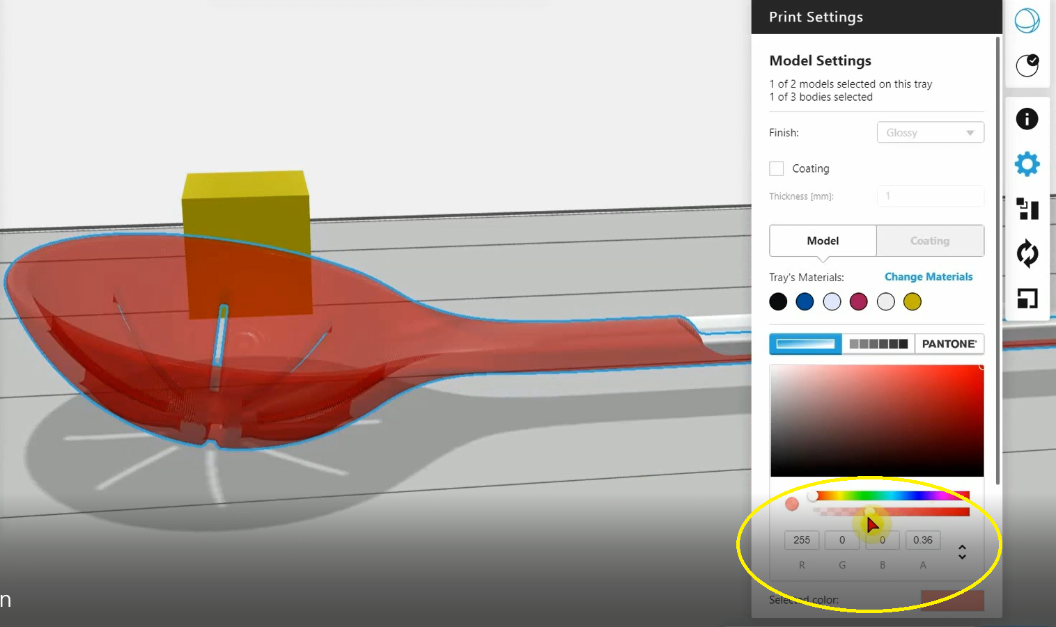

    The easiest way to add transparency in GrabCAD Print is to use the slider. It can be found under Model Settings along with the Color Picker. As you manipulate the transparency slider, the ratio of VeroClear and the Vero color of your choice will change.
    This can also be achieved by selecting Vero Clear or Vero UltraClear when you are within the tray material menu for complete transparency.
    The more transparent the part, the more VeroClear is being used. You can add transparency to a specific body or to the part as a whole.

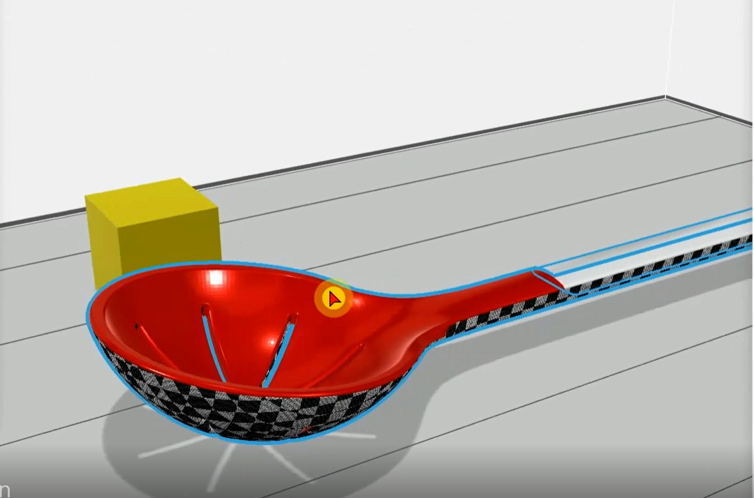

    Once you have the transparency of your choosing, it is very important to know where support material will touch your part especially if it is transparent! Sections of your print that have support material will make them matte instead of glossy.
    You can figure out what will end up matte or glossy by clicking on Preview Supported Surfaces. This will show you a binary view of the part.
    The checkerboard pattern indicates where support material will be present.
    If you have a part that has many faces like a gem or taillight, it is important to orient the part so that it is support material free. This prevents you from wasting unnecessary amounts of time post-processing which could also ruin your part!

    To add transparency in GrabCAD Print 1.38 version and earlier, select the area of the part you want to make transparent.
    • Click Print Settings
    • Click the color slider at the bottom
    Adjust the slider and move it to your desired transparency. As you move it, you'll notice the part becoming more transparent.
    Another way to add transparency is by simply inputting the Hex value into the code fields below the slider.

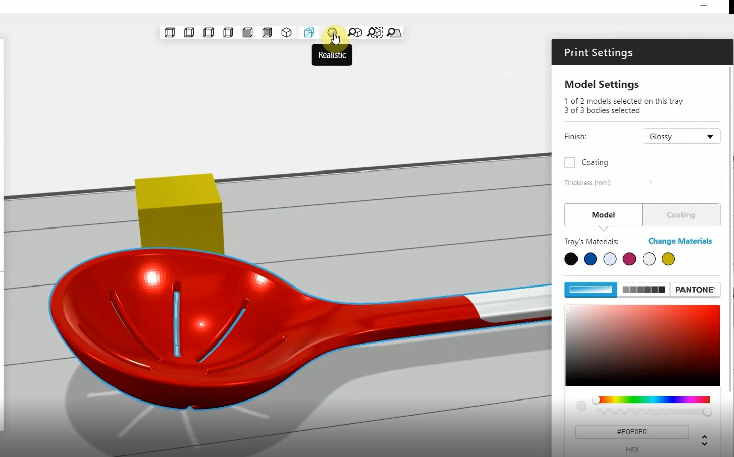

    Once you've selected your desired transparency, it's important to check where the support material will touch your part-- because remember, this will affect whether it has a matte or glossy finish.
    As you rotate the preview image, you can clearly see which areas are glossy and which are matte. However, if you want to double check this, click the Realistic ball icon at the top of the menu.
    The Realistic view gives you a binary view of the part. The hatching is indicative of where the support is going to be touching your part.
    If you're not OK with where the support material touches your part, change your part orientation to get the surface finish you want.
