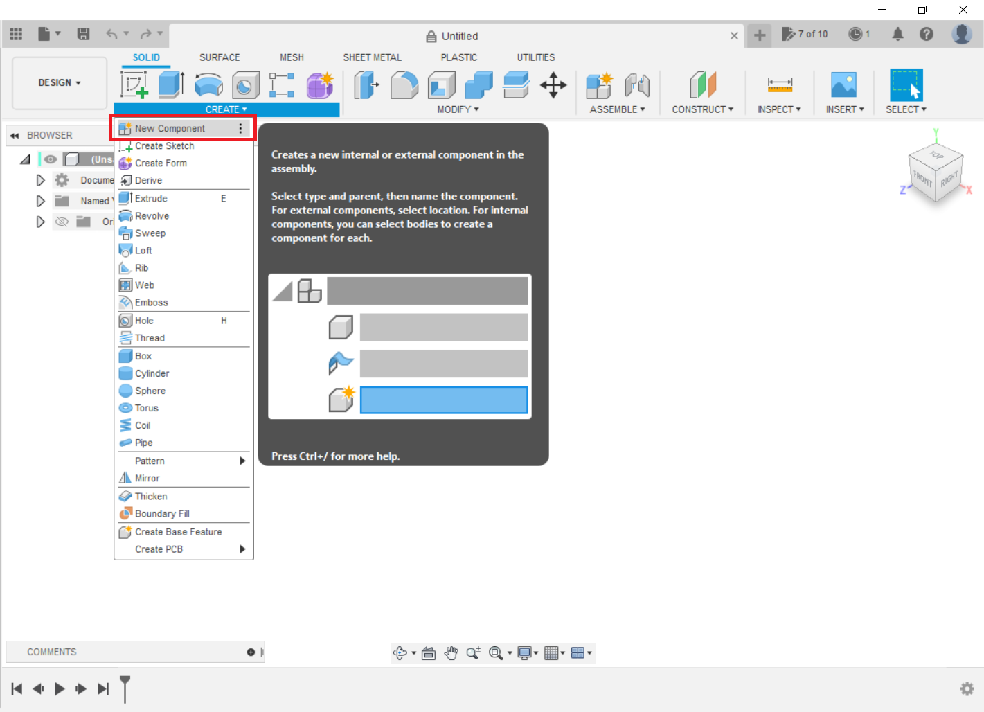

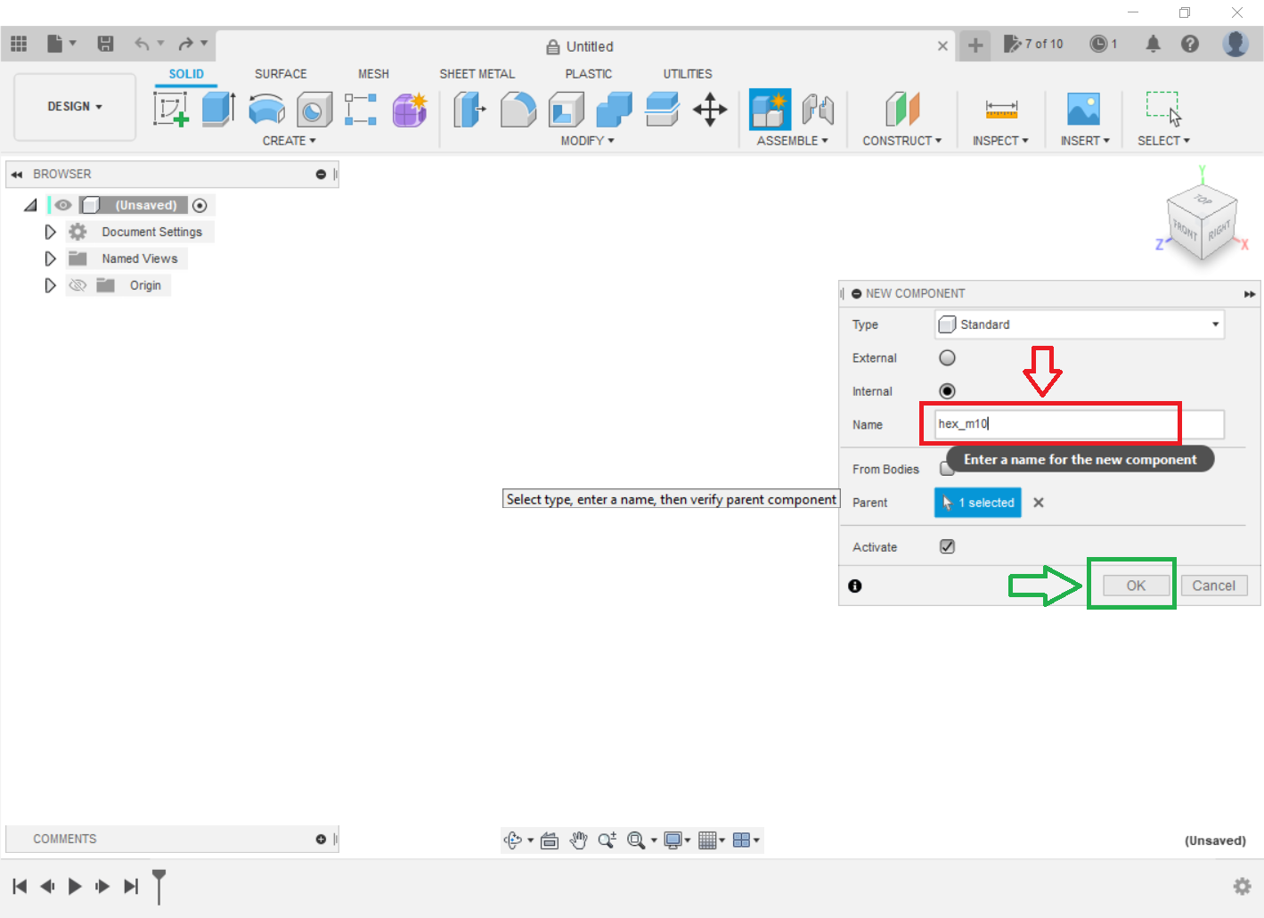

  1. Step 1: Create a component
    Go to create a select "New Component".
    I called it this way, but you can use any name you like. Press OK.

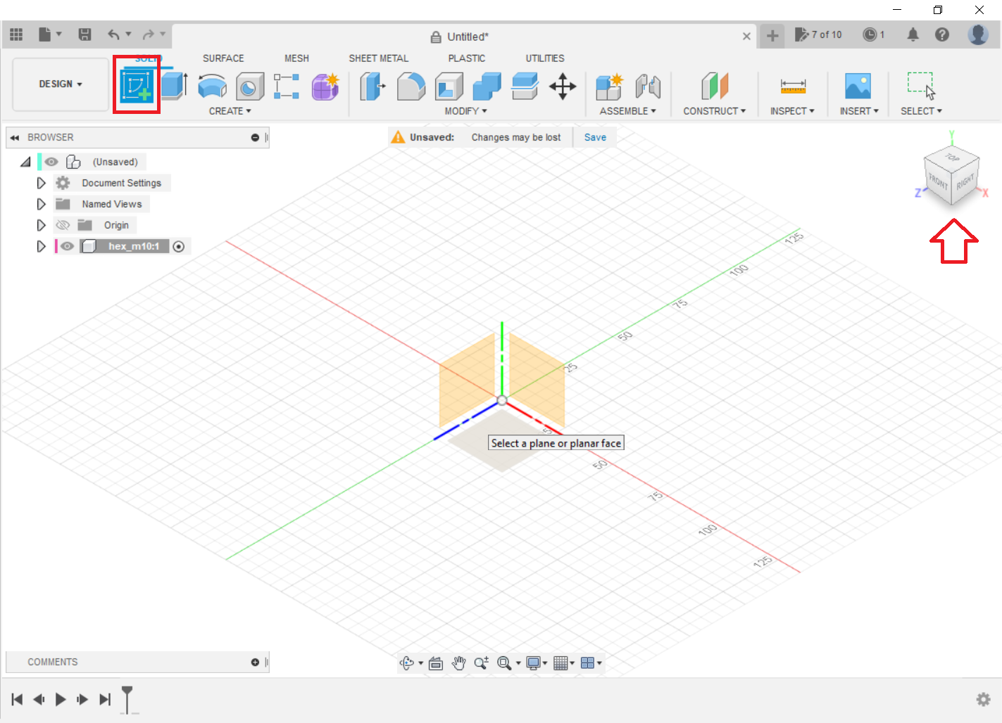

  2. Step 2: Create a sketch
    I used the XZ plane, as it seems to be a favorable default position for viewing and editing the model.

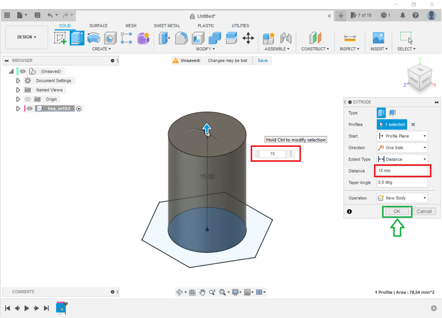

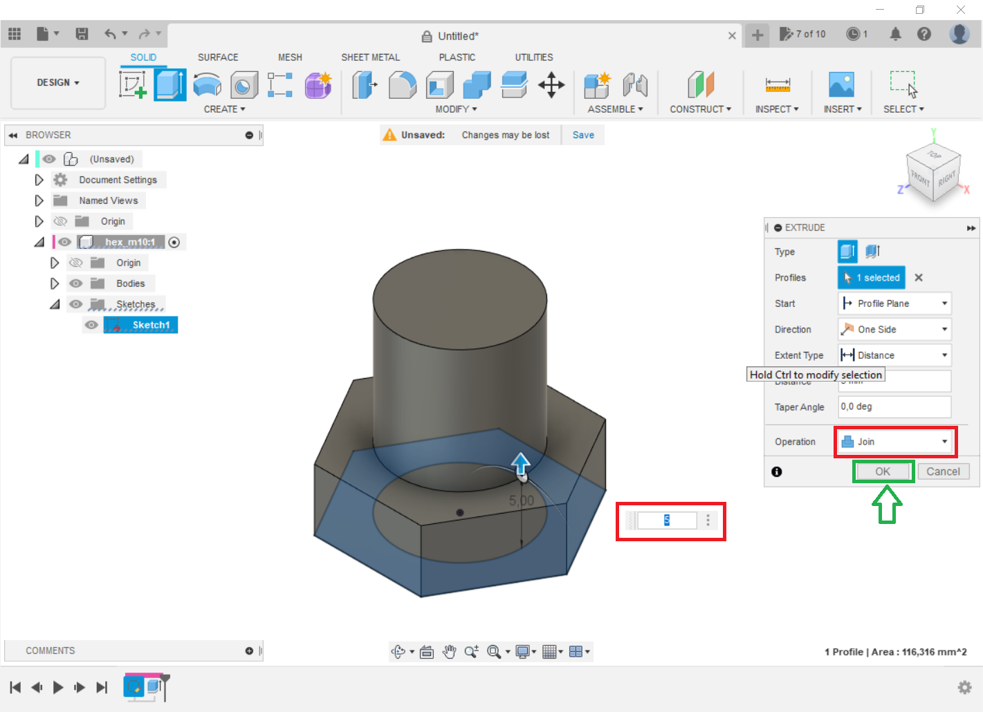

  4. Step 4: Create the screw.
    Extrude the circle using the indicated length, and then press OK.
    Extrude the hexagon using the indicated length, and then press OK. Don't forget to select the JOIN operation.

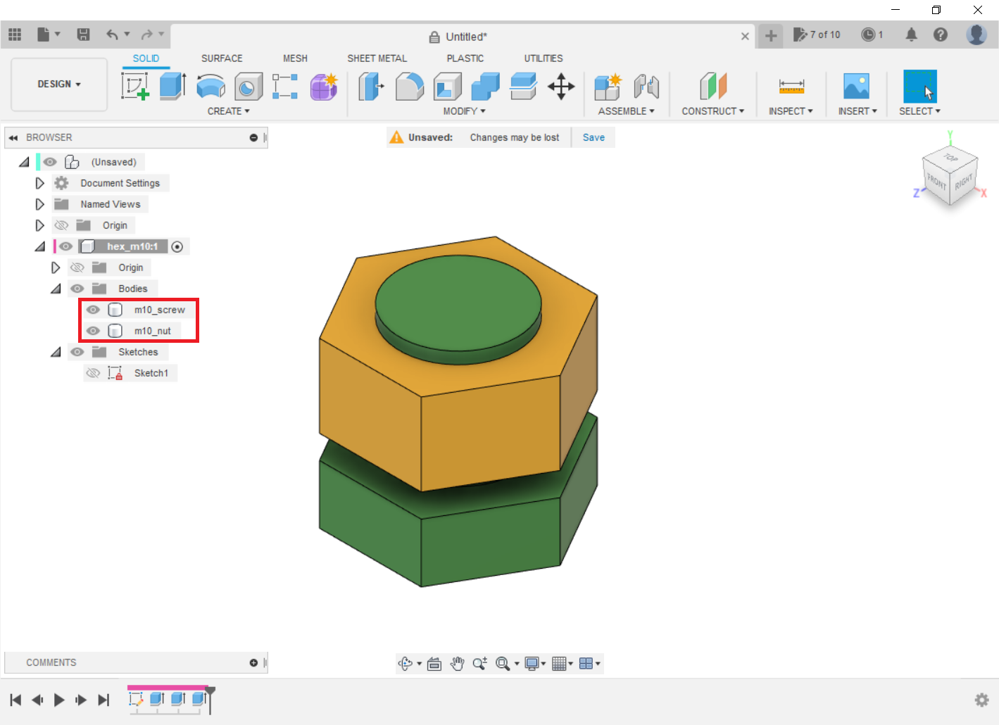

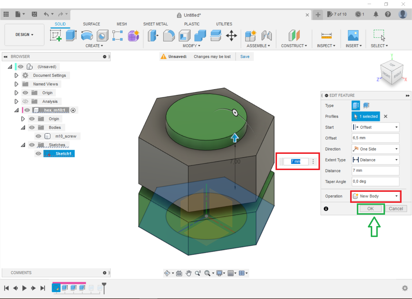

  5. Step 5: Create the nut
    Using the same sketch (sketch1), extrude the hexagon using the indicated length, and then press OK. Don't forget to select the NEW BODY operation.
    Don't forget to use an offset so that the extruded piece ends up in another place. I used 6.5 mm to make it easier to visualize the subsequent steps.

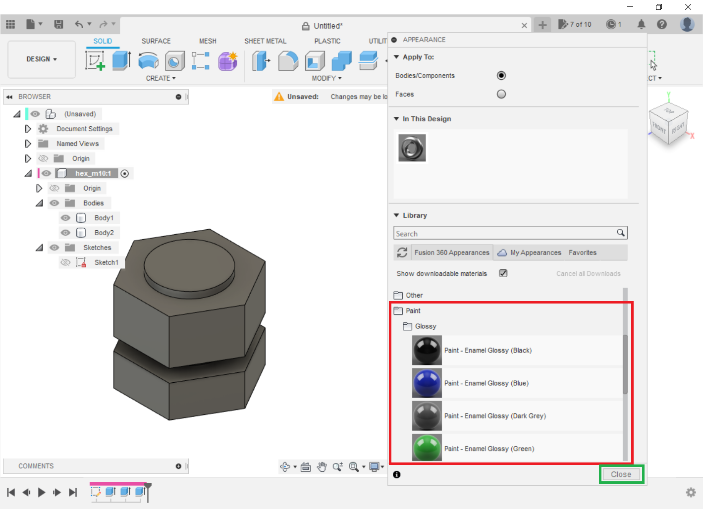

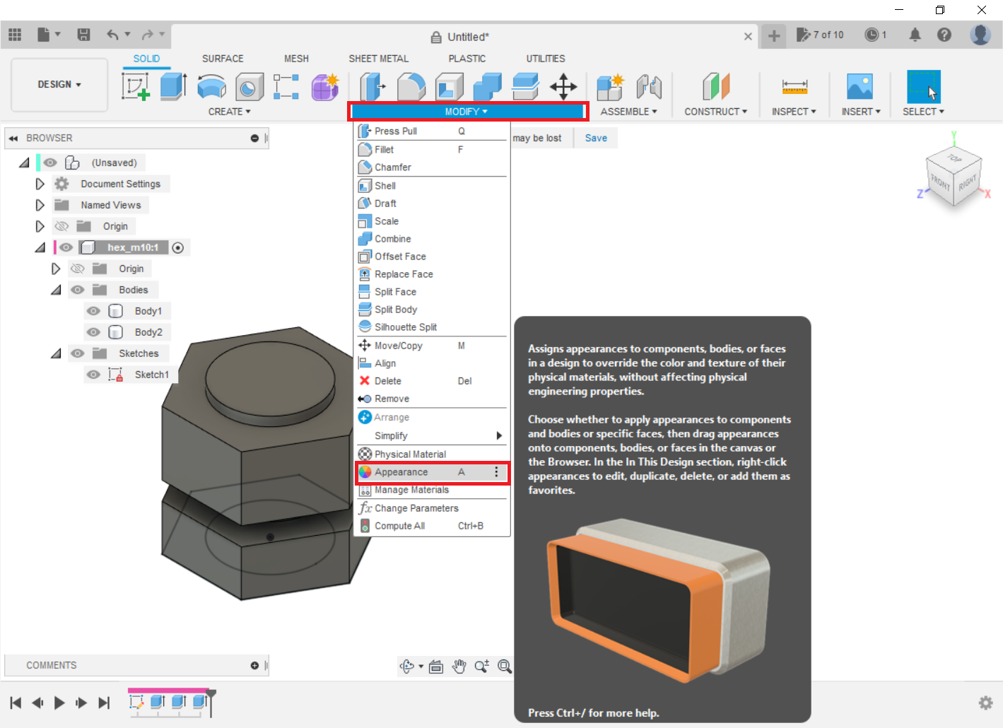

  6. Step 6: Change the appearance
    Go to Modify and Change the appearance.
    Select the one you like and drag them onto the bodies of the parts, in my case green and yellow. This is done solely for the purpose of facilitating visualization. Then Close.

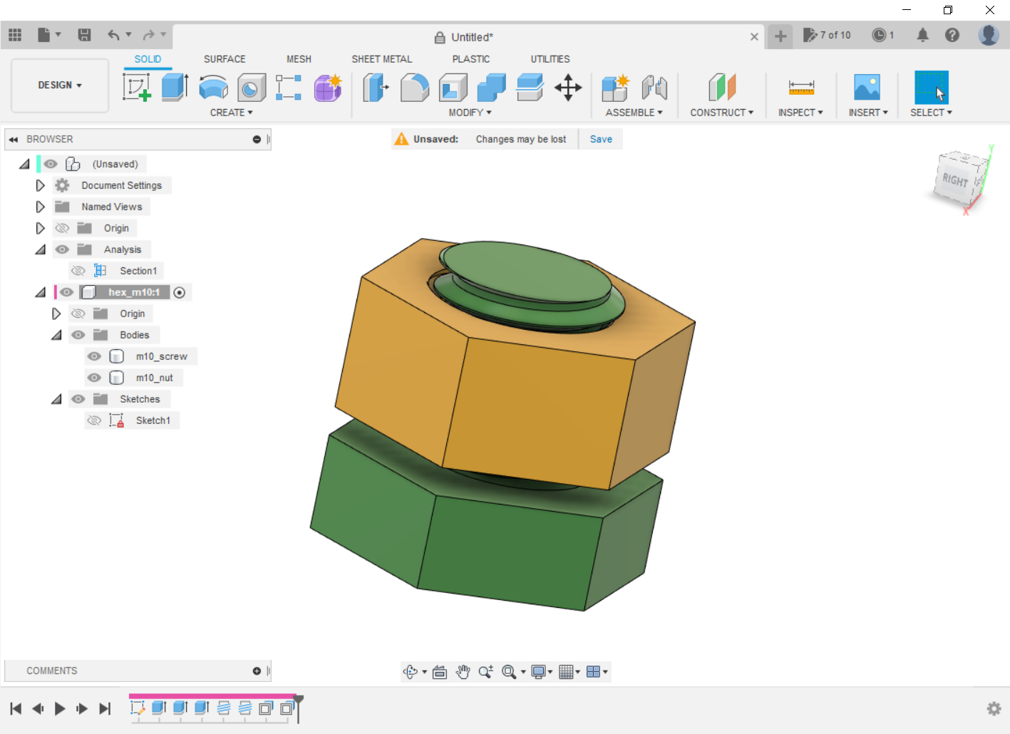

  7. Step 7: Change the names of the bodys
    Change the name of the bodies to make them easier to identify.

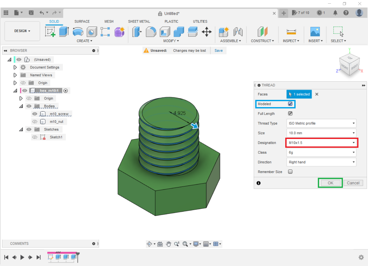

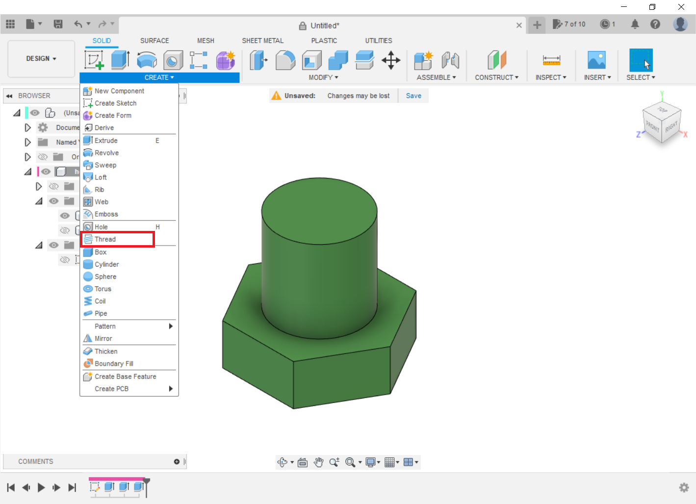

  8. Step 8: Modeling the threads
    Select the Create command Threat.
    Fusion 360 generates a list with the most approximate thread types to the diameter of the figure that will be modeled with this command. In this case, for a diameter of 10, we will make an M10 thread.

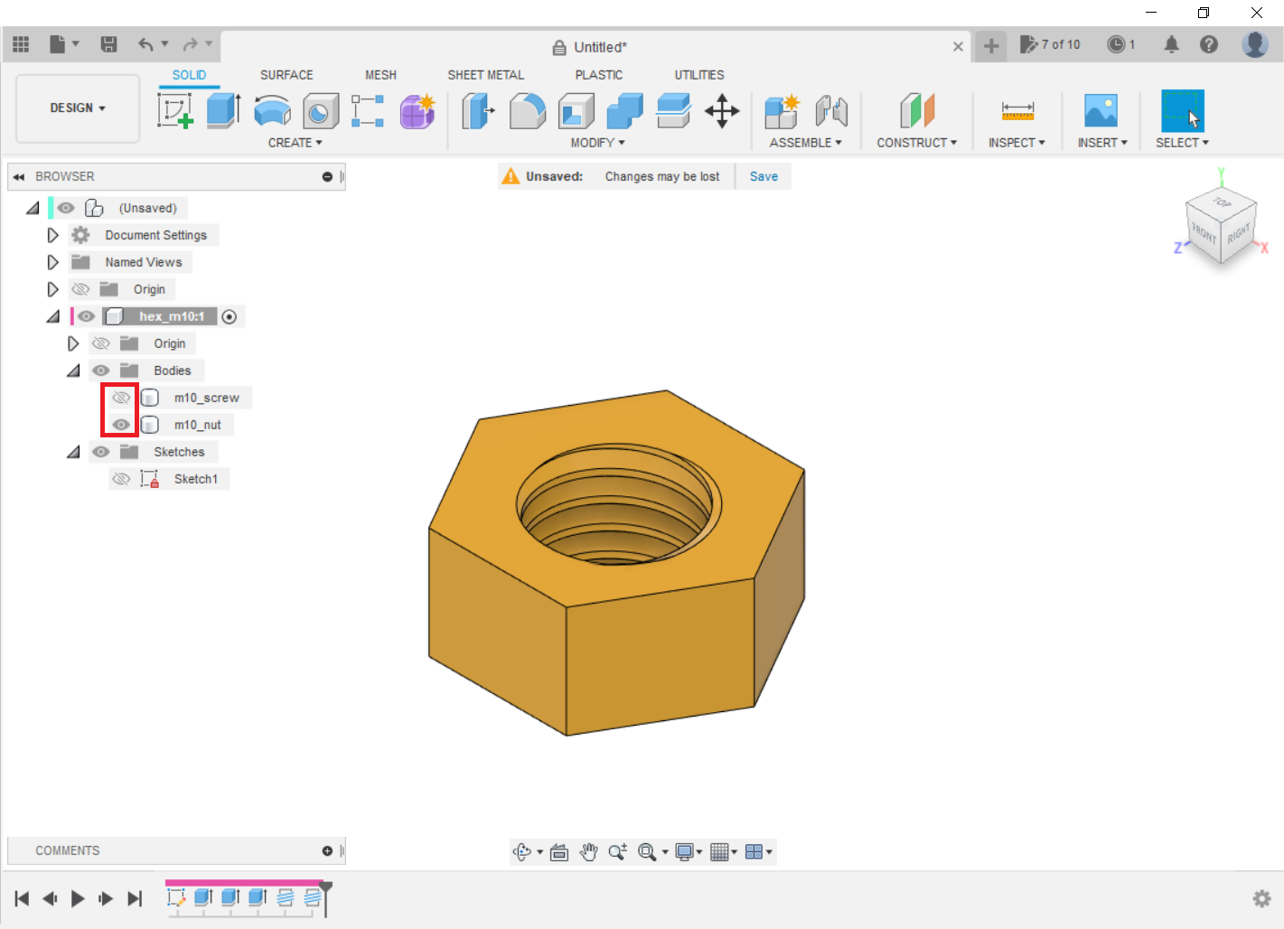

    Repeat for the nut. For easy selection, do not forget to turn ON/OFF bodies.

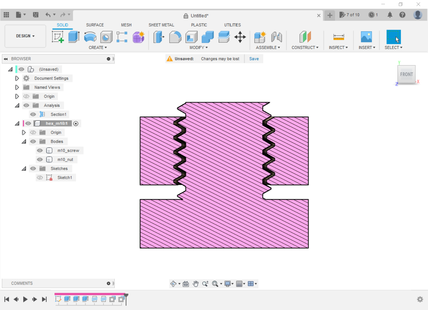

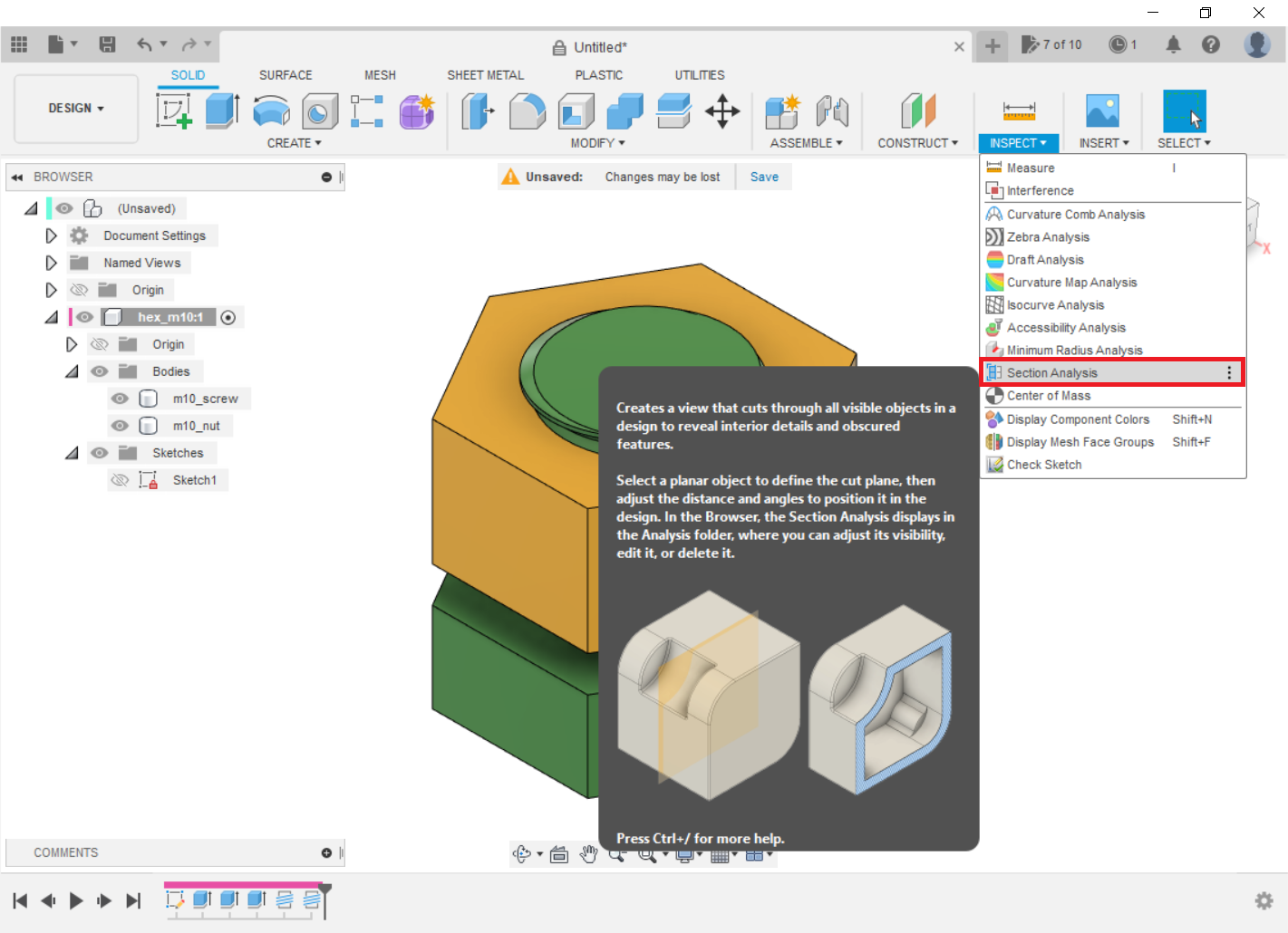

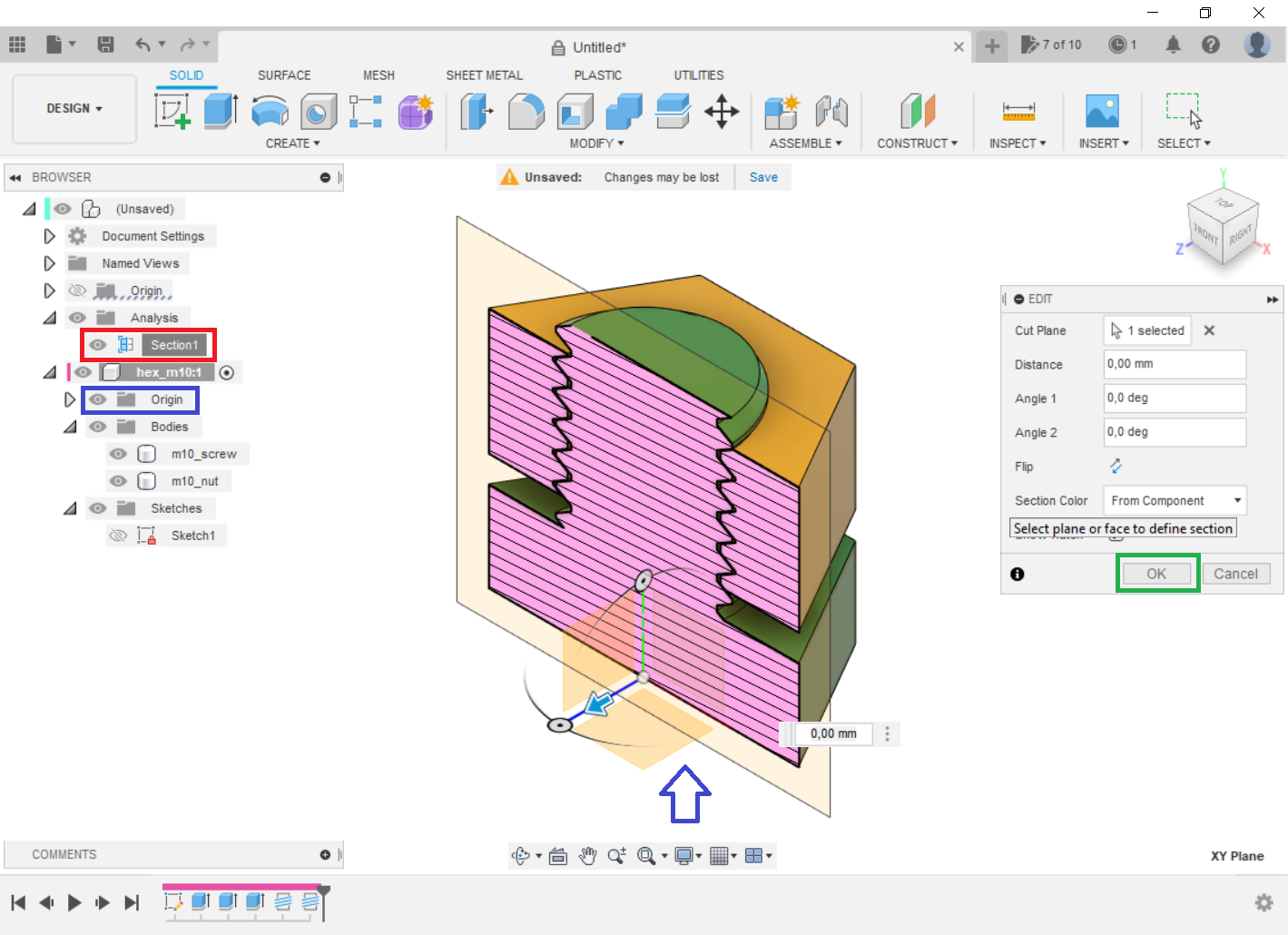

  9. Step 9: Create an inspection plane
    In the Inspect section, select Section Analysis.
    To visualize easily, it is convenient to use an intermediate plane, in this case the XY (to easily locate turn ON the origin). Finally, press OK.

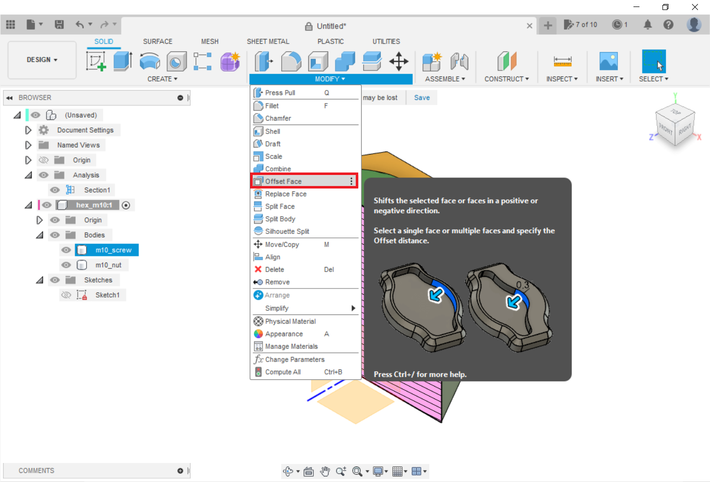

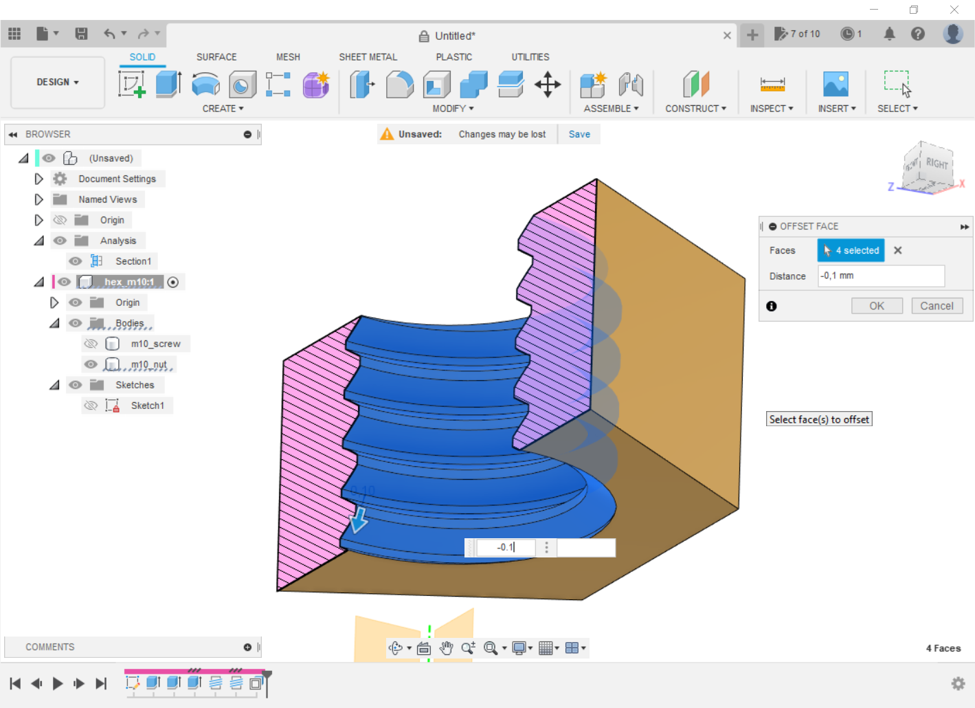

  10. Step 10: Adjusting the thread tolerance

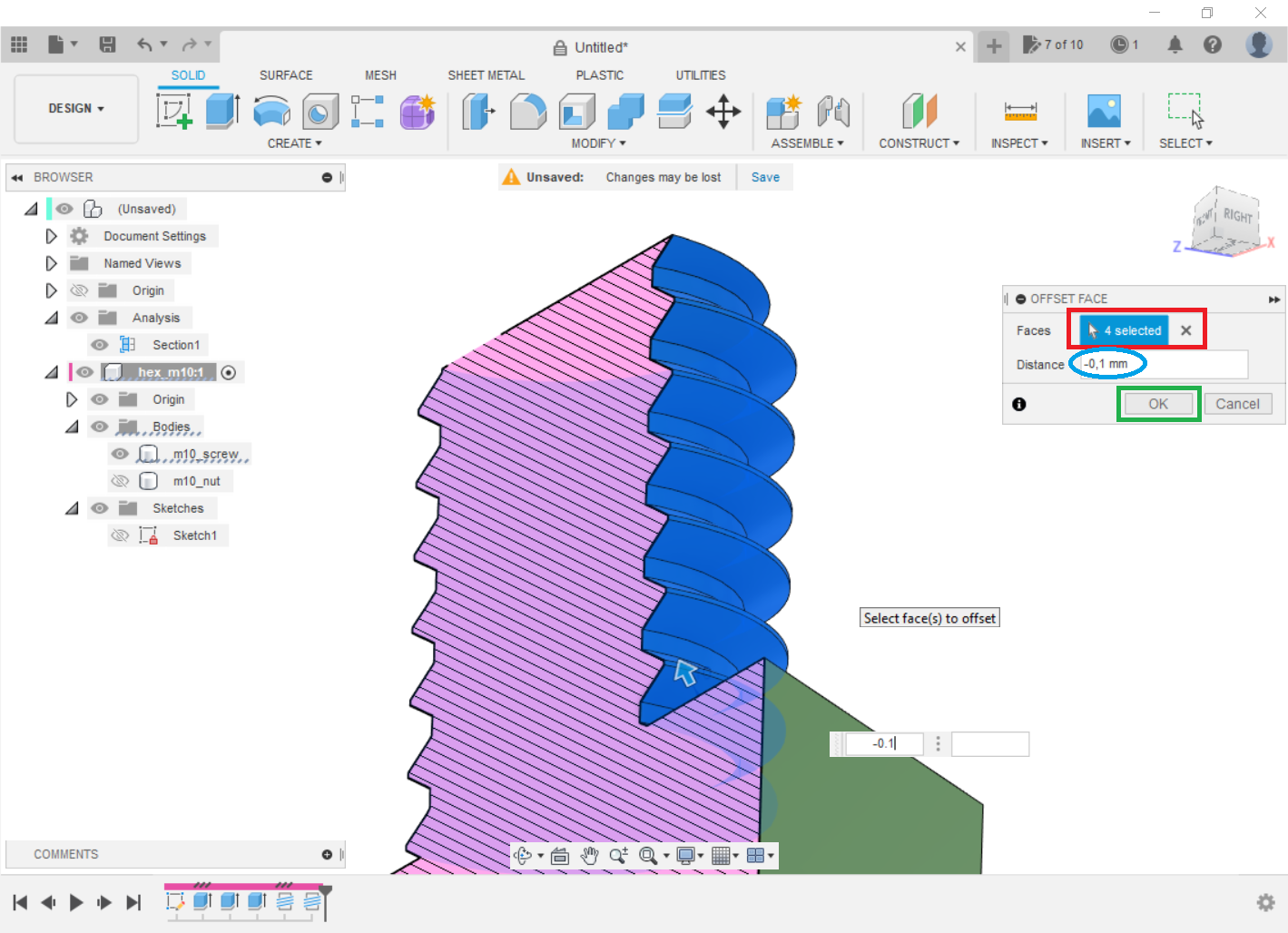

    This is the most important step, from this one can obtain a functional thread for 3D printing. In the Modify section, select the Offset Face command.
    Turn off the nut and select the 4 faces of the screw thread (be careful to select all 4 faces) and assign an offset of -0.1 mm (you can adjust this for your printer tolerance, but 0.1mm usually works very well). Then press OK.
    Repeat the procedure for the nut.
    It should result in something like this:

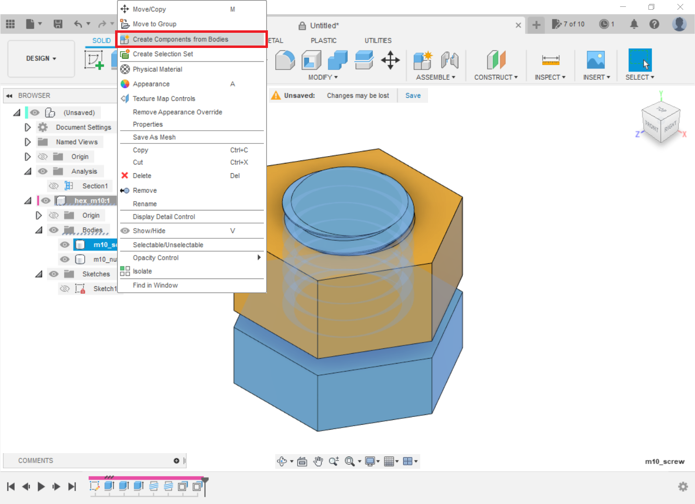

  11. Step 11: Create components
    This step is done only to facilitate exporting and mesh generation.
    Select the screw and in the Create section, use the Create Component from Body command and repeat for the nut.

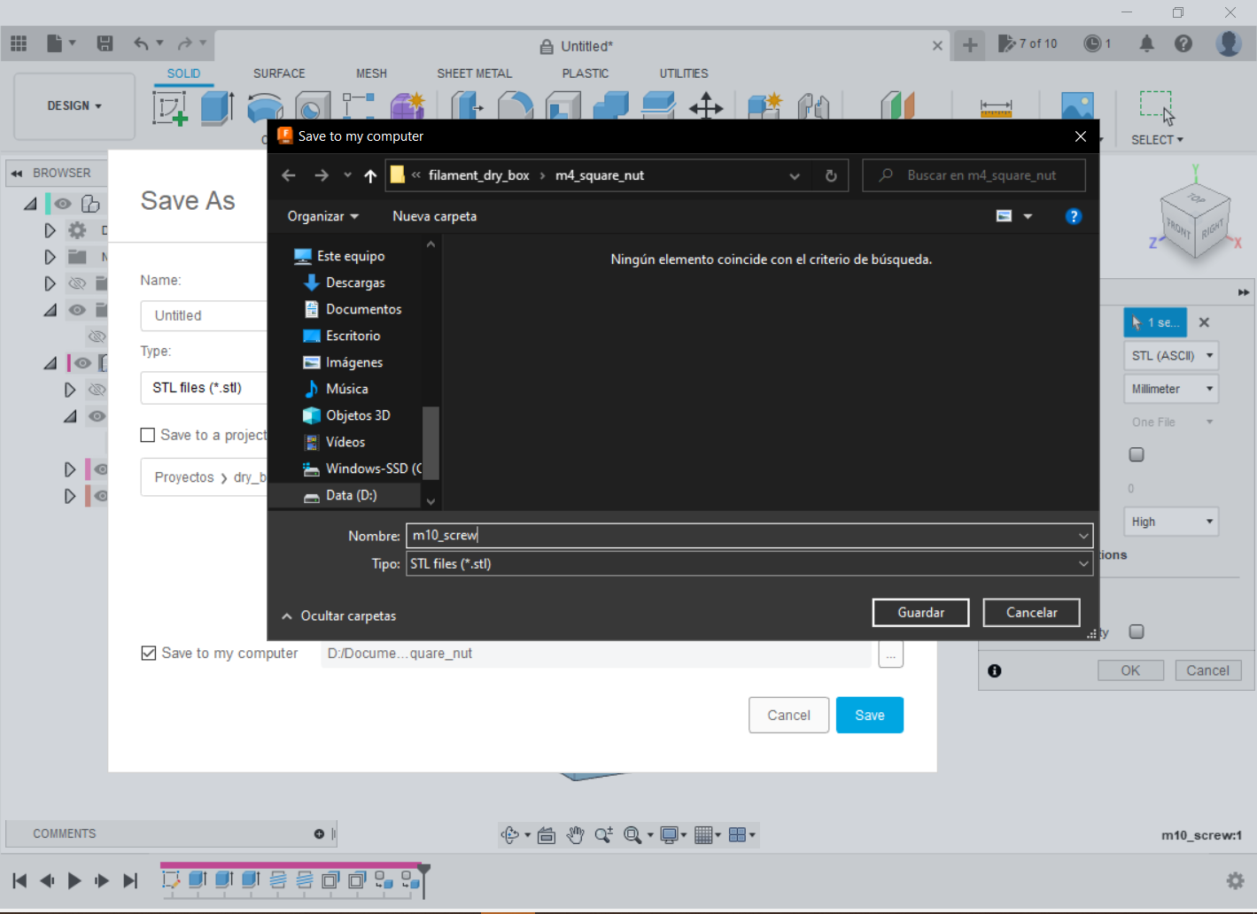

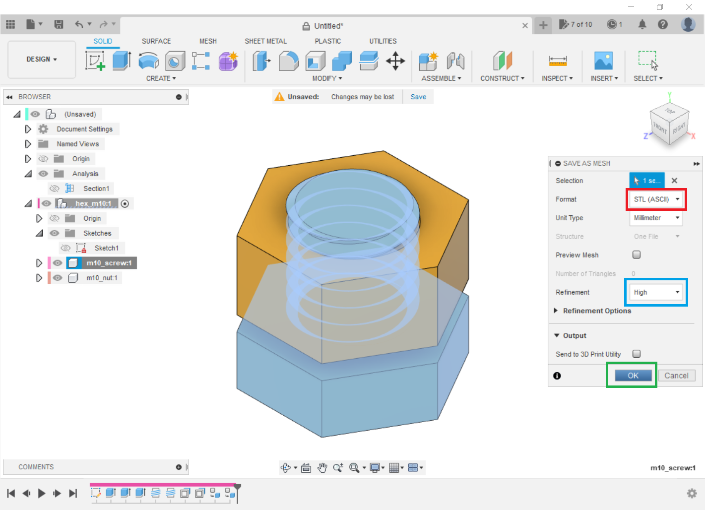

  12. Step 12: Save as mesh
    Select the Save as Mesh command.
    Be sure to select the STL (ASCII) format and a high mesh refinement. Then press OK.
    Note: the current version of PrusaSlicer allows the use of .step files, but Ultimaker Cura Slicer does not use this type of file at the moment. For this reason, we export to STL in the example.

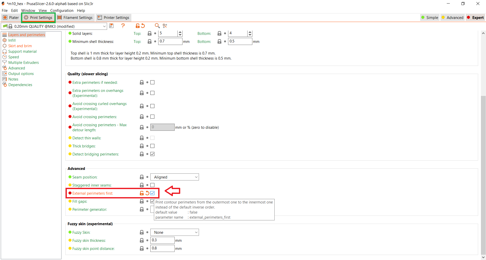

    In the Print Settings section, you can also choose to print external perimeters first to improve precision.

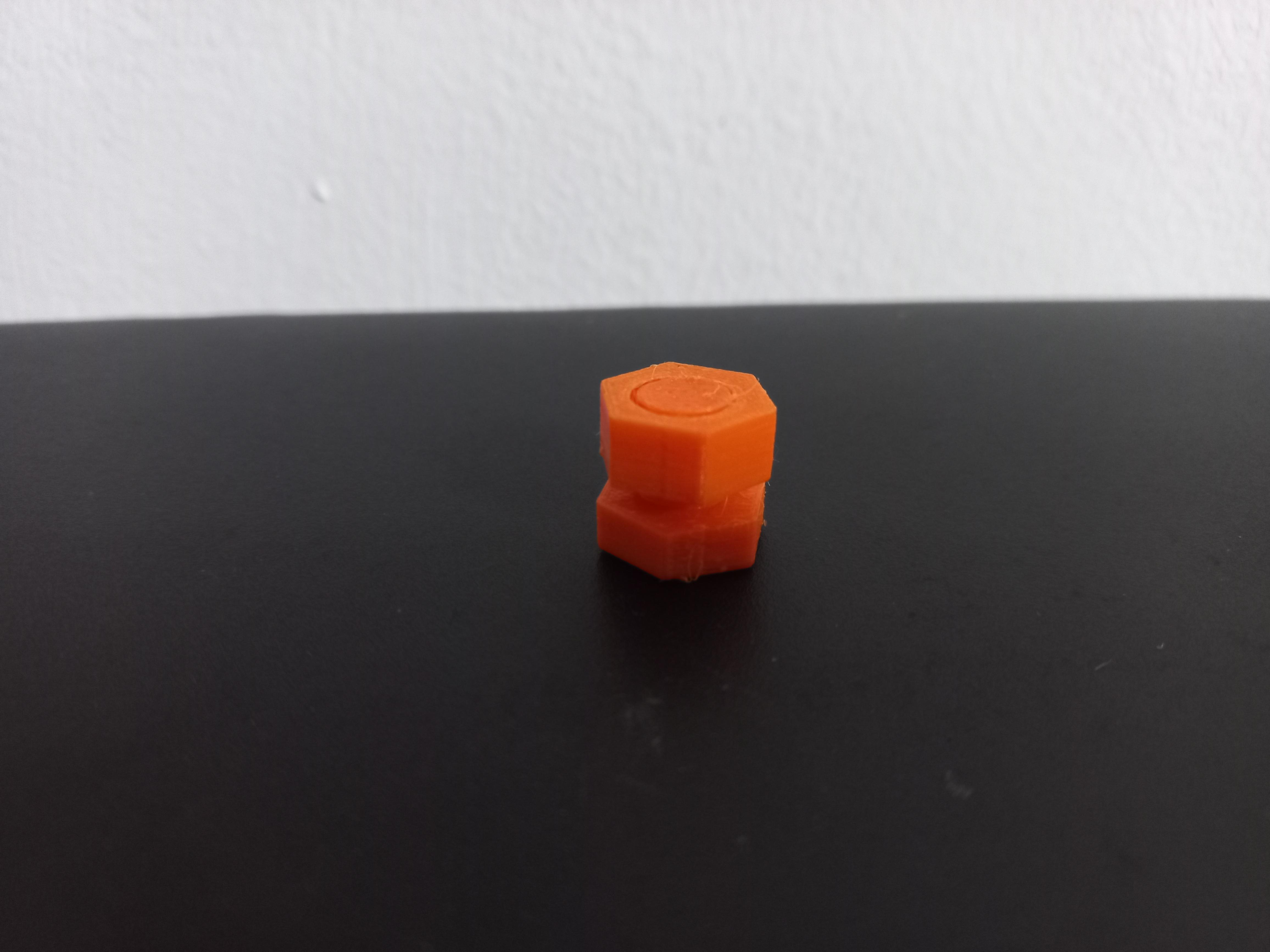

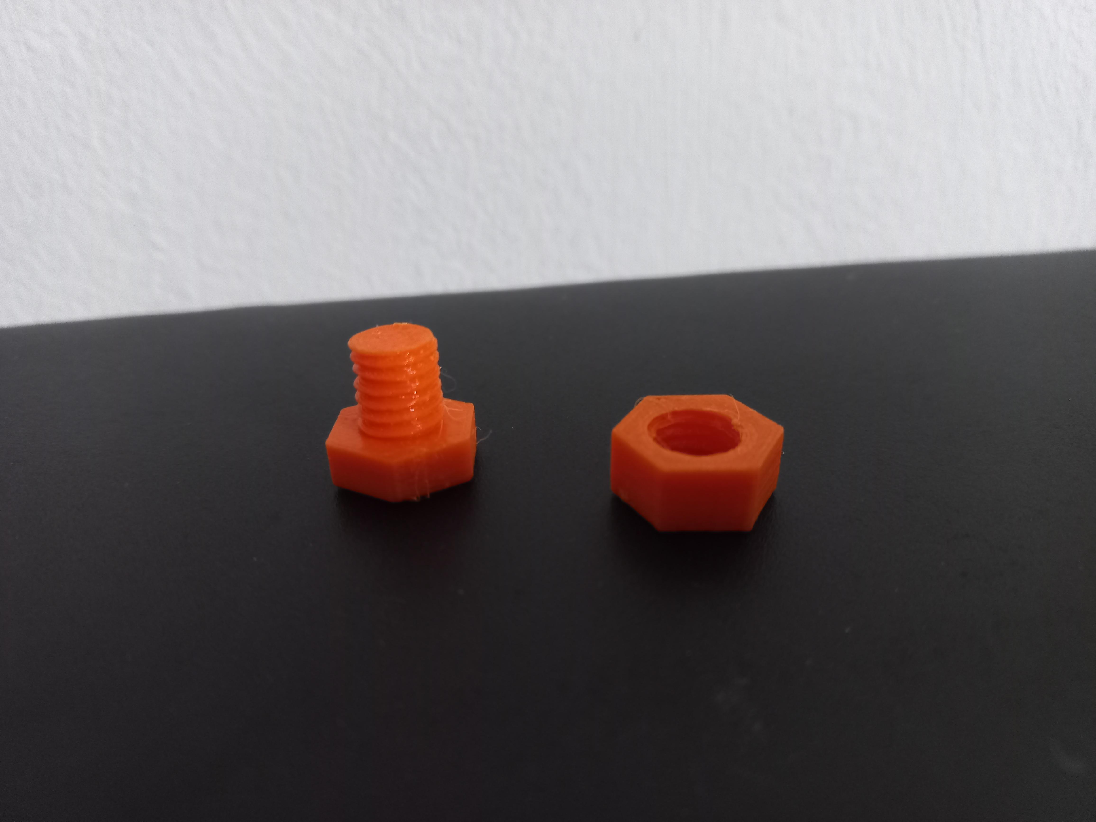

  14. Step 14: Printing (results)
    As mentioned earlier, it may be necessary to adjust the tolerance of the offset. -0.15 or -0.20 should work, but if you need less than this, I think you should review the conditions and settings of your printer.
    Also, as I said before, for bigger screws you will get better results.
