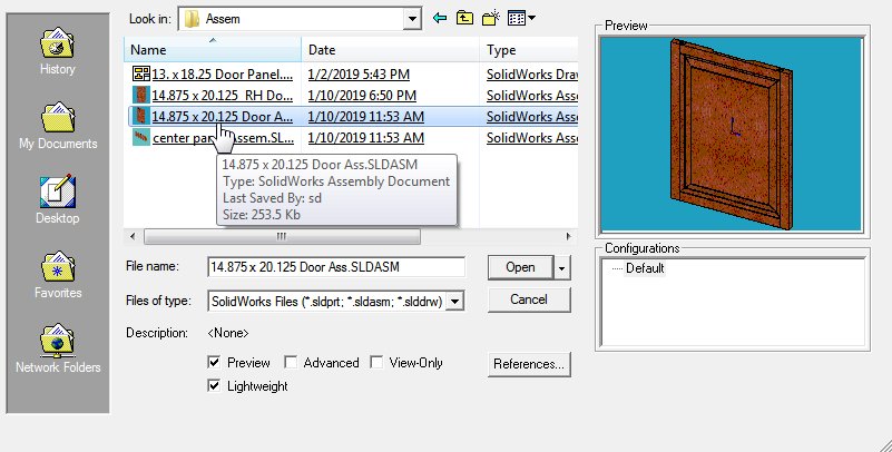

  1. Step 1: Download file
    Download the file from my models page( https://grabcad.com/library/14-875-x-20-125-door-ass-1)
  2. Step 2: Open assembly
  3. Step 3: Open 14.875 x 20.125 Door frame.SLDPRT)

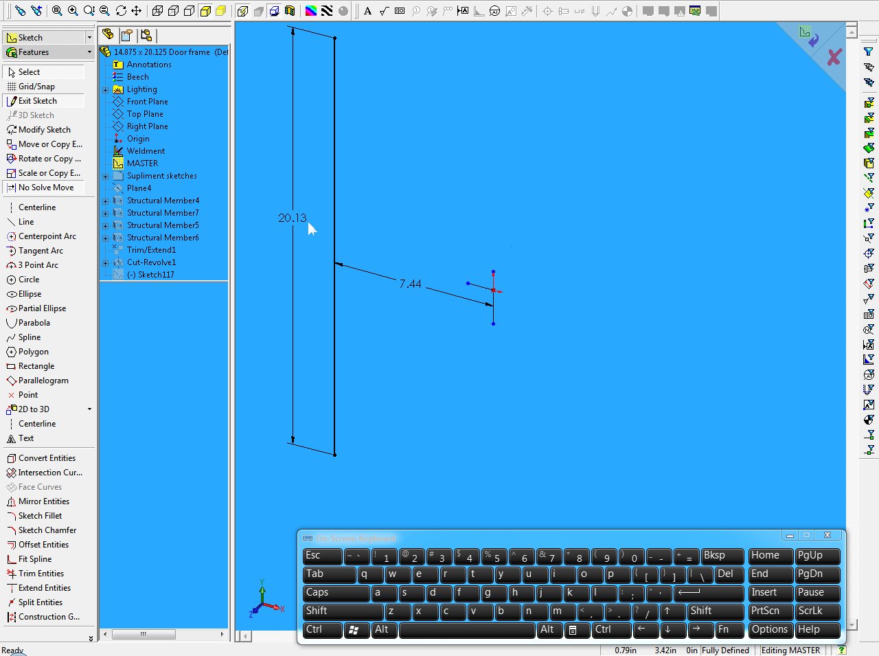

  4. Step 4: Edit MASTER sketch
    In the master sketch the vertical line controls the height of the door frame. It contains a symmetric relation between the upper point, lower point and the horizontal center line (@ sketch origin) and a line length dimension ( 20.13"). It also contains a distance (7.44 ") relation to the vertical center line (@ sketch origin).
    These are the main features in this sketch that will control the height and width of the door frame.

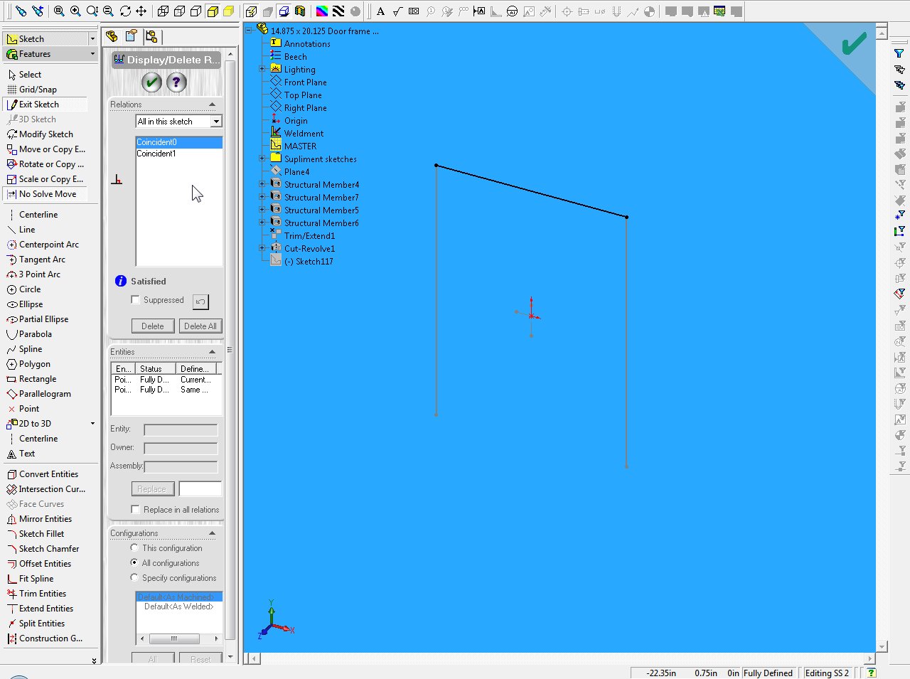

  6. Step 6: Supplemental sketches (SS 2 & 3)
    (SS 2) New sketch.
    draw a horizontal line between top points of (master & ss 1) sketch as shown below.
    The relations are coincident at the points.
    Exit sketch.

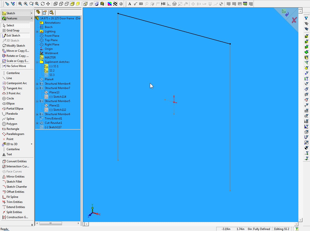

    (SS 3) New sketch
    draw a horizontal line between bottom points of (master & ss 1) sketch as shown below.
    Exit sketch.
    After all three supplemental sketches are made add them to new folder and name the folder "supplemental sketches" or whatever you want.
    So by creating the relations from SS 1 to MASTER and from SS 2 to SS 1 and from SS 3 TO SS 2 All the supplemental sketches are linked to the MASTER.
    Therefore the size of the frame is controlled by only changing the two dimensions in the master sketch.

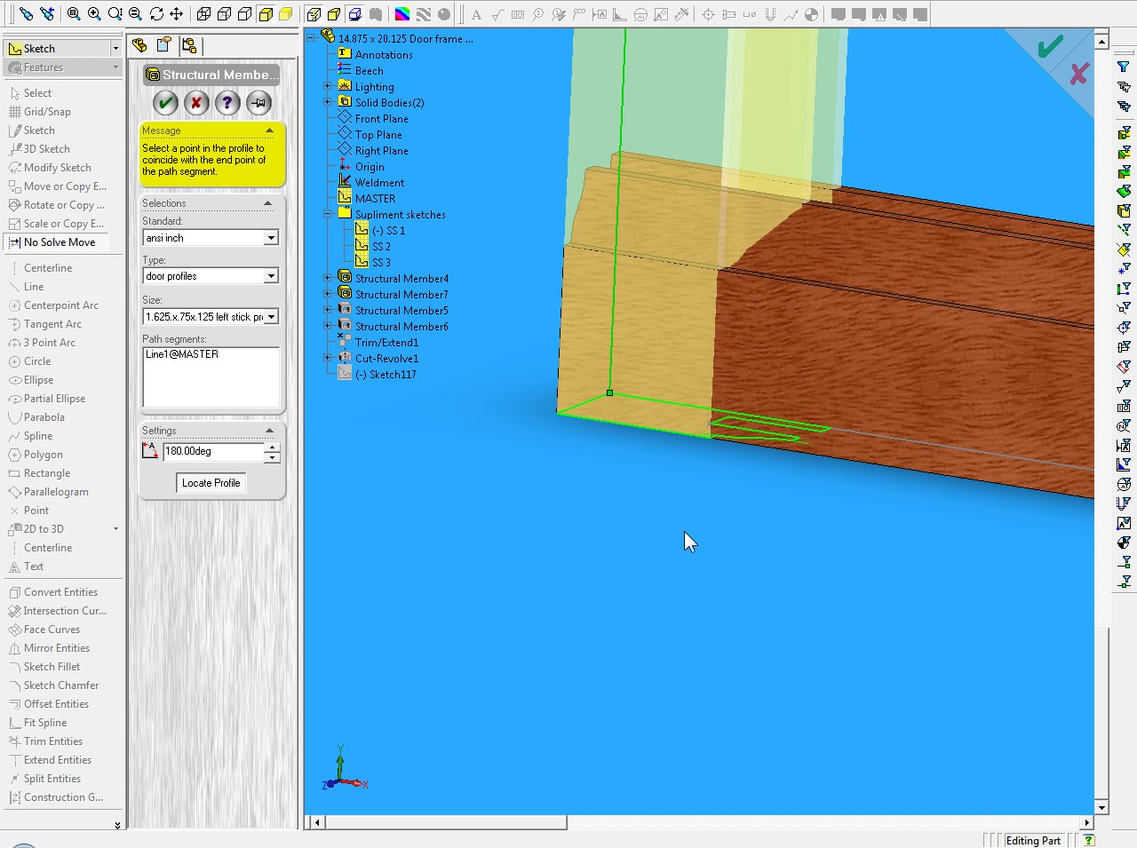

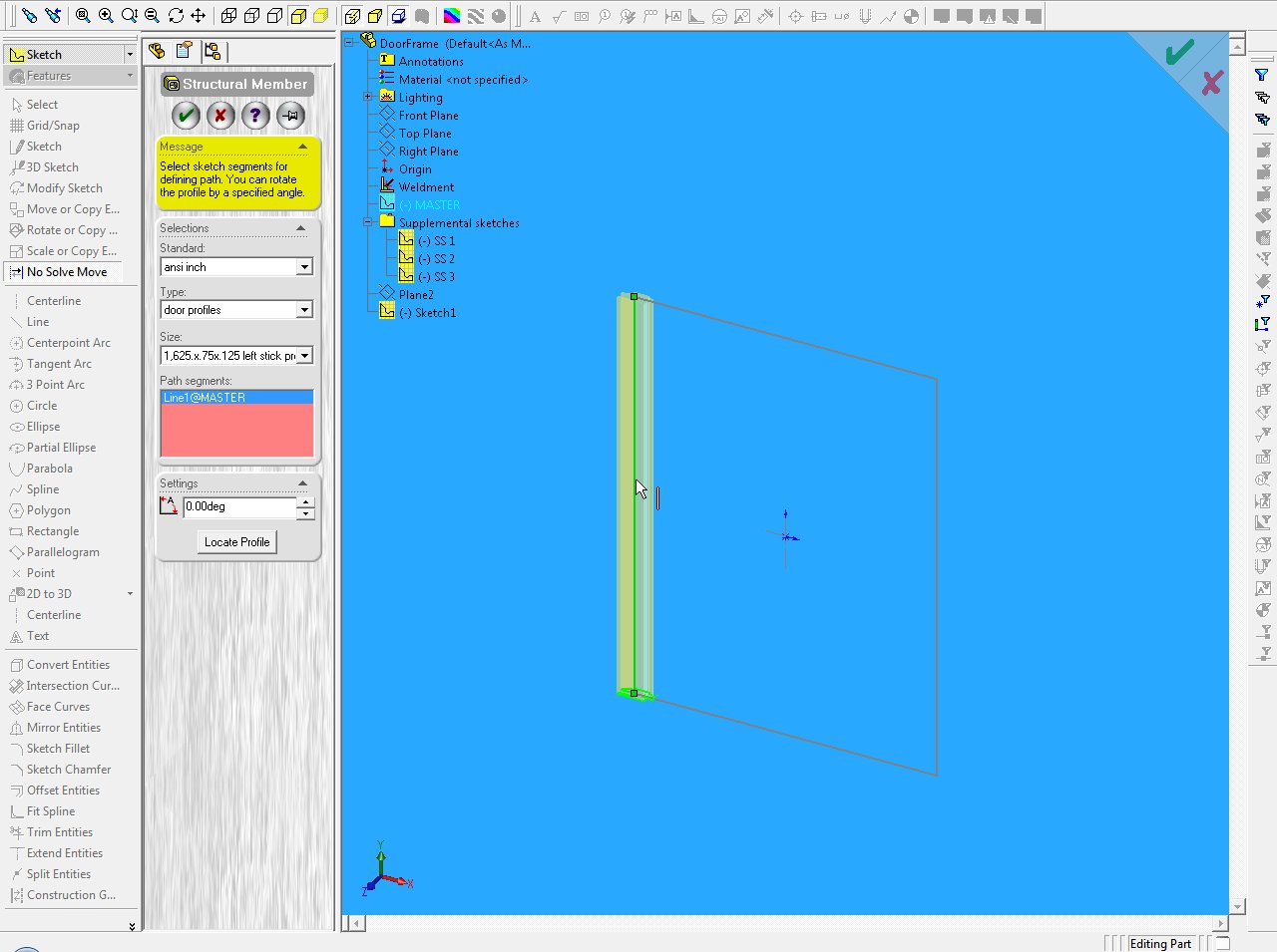

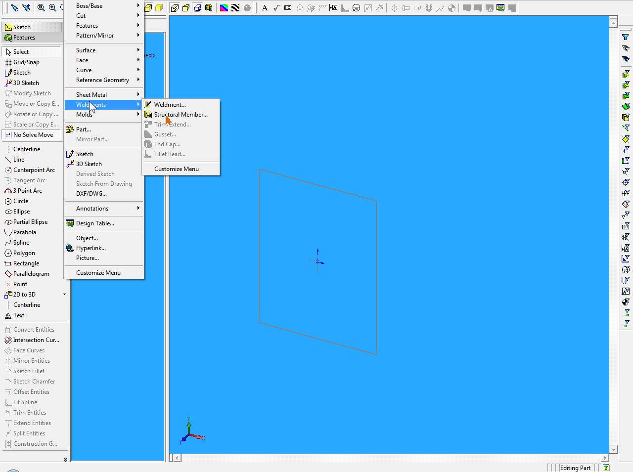

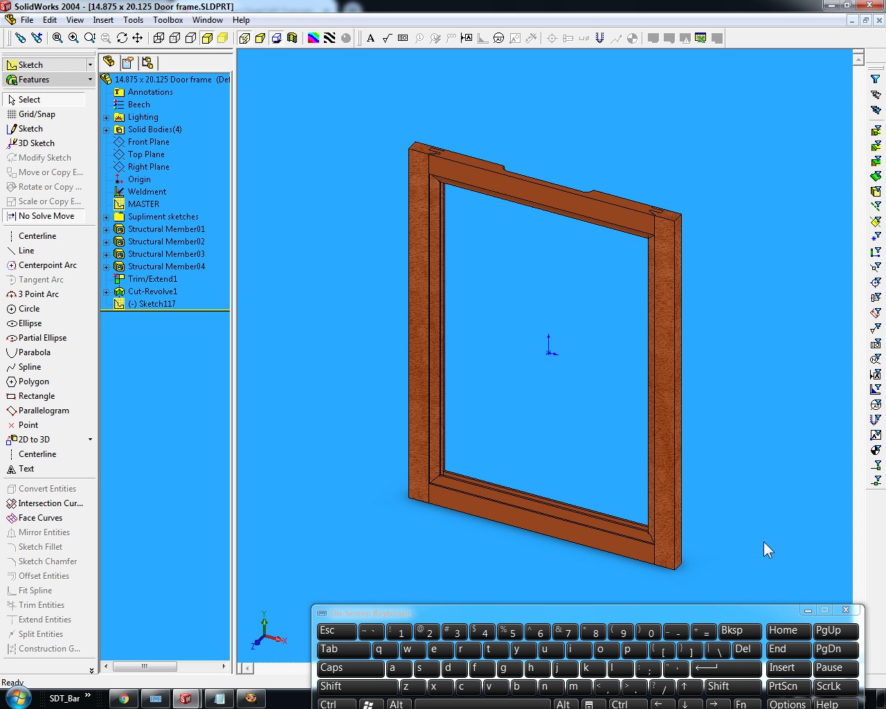

  7. Step 7: Create a Weldment
    Insert weldments.
    Select Structural member.
    Select the desired profile from the type and size drop menus and click the line which is in the master sketch. (shown below)
    Rotate the profile if needed and locate (orientate) its position on the line as shown below.
    Hit Enter or OK.
    Fallow the same steps for SS 1, SS 2 and SS 3

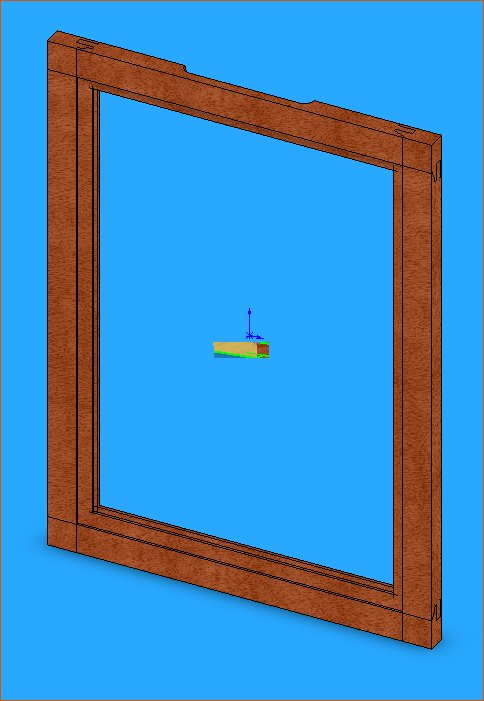

    I should look something like below.

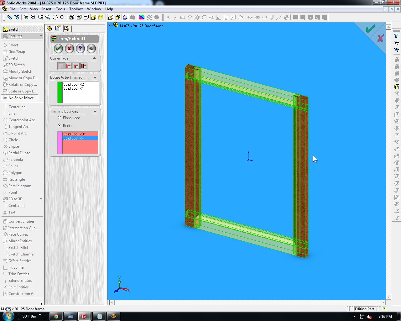

    Next is to trim ends of horizontal rails
    click Insert > weldments > trim/extend
    Select the top and bottom rails as the bodies to be trimmed and
    Select the left an right stiles as the trimming boundary.
    (Make sure the "bodies" is selected in the "trimming boundary" in the "feature manager design tree". (below)
    Tada!

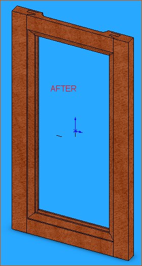

  8. Step 8: Adjust MASTER sketch to resize
    Edit the MASTER sketch
    Change the line length smaller x 3" ad the distance from center line smaller by 3"
    exit sketch.
    Should look like below. (before & after)
